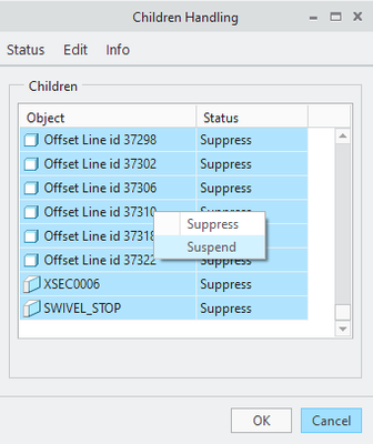

reload file would be a good idea. just trialed the suppressing method and it works but as the part was the 2nd in the tree lots of other parts below it also suppressed.

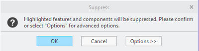

When suppressing, if you see Options>> button, select options button to control how related parts are handled.
In the Children Handling window press Ctrl+A to select all, then RMB and select Suspend.  Select OK.
The parts will now fail placement, but that is fine.  When the part is unsupressed all of the failures should be repaired.
