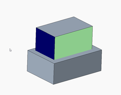

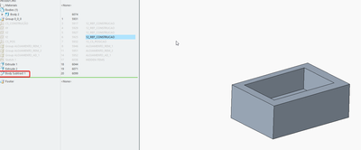

I notice you have the latest version with multi-body functionality.  I wonder if you could get the colors to stay with the body?  I guess I'm thinking of a work-around where the volume of the holes is modelled in a body that is subtracted away from the main body.  Does that operation preserve the surface colors?
T_F
(To:pausob)
Unfortenately no!
two bodies:
After the subtract
TomU
(To:pausob)
This concept was discussed extensively on the 'Creo 8 Holes' working group.  Unfortunately the multi-body capabilities aren't currently capable of transferring this color information or any of the other hole related information that would be needed in the downstream part (cosmetic thread, thread series, thread pitch, etc.)

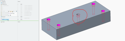

MartinHanak
(To:T_F)
I assume the following trick is not the solution to your problem ...
  • assign magenta color to part
  • assign grey color to all solid surfaces of the part
  • create a hole ... magenta color appears on hole surfaces
Unfortunatelly any material removal displays newly created surfaces in magenta color.
Martin Hanák
That's true!
But I will have a mix a of counterbored holes and pin holes! One is pink another is blue!
