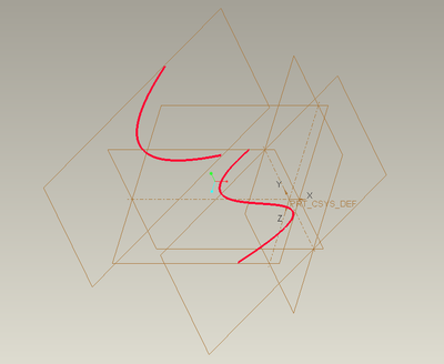

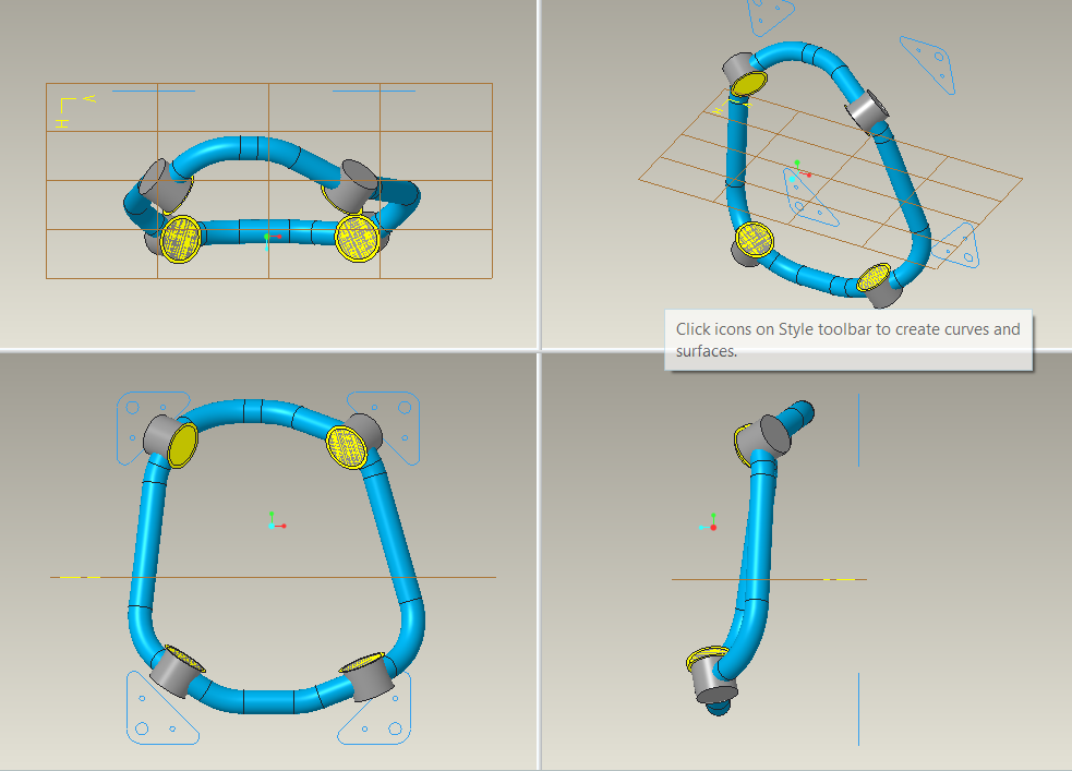

Here is a quick sample model (Creo 7) of how to use two planar curves to generate a 3D curve. If you can sketch on two planes to create the route this will work and is quite robust. You do need to insure that the curves actually intersect when you do this. If you need a visual cue when working then just extrude a surface from one or both curves.
Create two planar curves that represent the routing path projected onto a plane. I used splines for each planar sketch in this example. They do not have to be splines but the intersection of the curves should maintain G1 (tangency) or higher continuity to be a robust sweep trajectory.
Intersect the curves to generate the sweep trajectory 3D curve

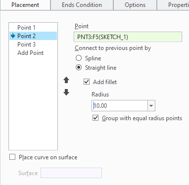

  2. Curve through points with straight lines and added fillets.

tbraxton
(To:eharmony_916)

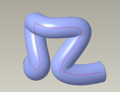

This illustrates 3D tube routing using the method (intersection of curves) mentioned by @kdirth above. All of these tubes are CNC bent and laser cut to join the cylindrical connectors. It works quite well for 3D routing problems but can be tedious. All of the 3D routes seen here were created by intersecting two planar curves to create a 3D curve. A skeleton model is used to manage constraints such as min bend radius on the tubing so the sweep trajectories are on the center line of the tubing which makes programming the CNC bender faster. It looks quite rudimentary but is not trivial to model with all of  the constraints.

eharmony_916
(To:tbraxton)
Thank you to all that have replied. I really do appreciate the efforts!
I have been using the curve thru points and adding fillets when possible or needed.
Again, thank you. I am familiar with this technique but find it very similar to generating sketched curves. (tedious)
That seems the easiest but also has the same problem of generating points in 3D model space.
In the diagram shown I see 4 sketches but do not see how that generated your complex curve and or points?
Perhaps I am not so fluent in the curve intersecting routine. I do like the points for drawing dimensioning aspects.
Those can be generated easily from a completed tube-form.
Is there any chance a file could be shared for the illustrations sent above (kdirth)? Or a good You Tube link.

tbraxton
(To:eharmony_916)

tbraxton
(To:eharmony_916)

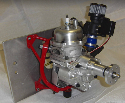

Here is a picture showing a prototype of the welded tube assembly (in red). The four corners you refer to were a fixed geometric constraint that the tubes all have to terminate on. All of the tubes required a "fish mouth" contour to mate with the mounts. They house vibration isolators.
If you do a lot of cable or tube routing you should demo the routed systems extension to see if it is worth the cost.

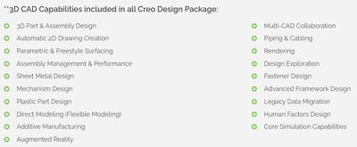

You also may want to review your ptc license. https://www.ptc.com/en/products/creo/packages shows piping and cabling as part of "all creo design packages". In an assy, check under applications piping (always when you have any assy open, not a part)
I know that if the original license purchase was many years ago, the licenses may be different.

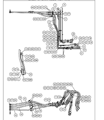

StephenW
(To:eharmony_916)

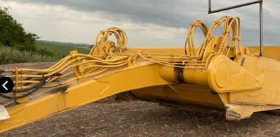

Hyd. tubing and piping is going to be tedious.
From previous experience in earthmoving industry. All down top down in Creo (well Pro/E Pro/piping), then complete fabrication drawings for production line build. I've used it for hydraulics, air lines, and fuel lines and several other random applications.

TomU
(To:tbraxton)
@tbraxton,
Just out of curiosity, is that for an RC airplane, paramotor, or something similar?
tbraxton
(To:TomU)
Something similar, operated by an agency of the US DOD.

tbraxton
(To:TomU)
Commercial propulsion unit that uses the same  combustion improvement technology developed with the prototypes.
https://www.unmannedsystemstechnology.com/2016/01/hirth-motors-unveils-new-15hp-cots-uav-engine/
