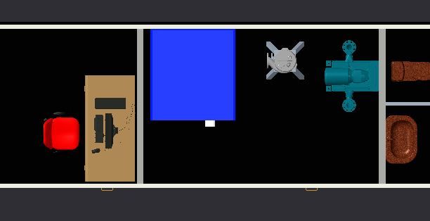

When I open an creo parametric assembly in creo view, the decals and textures are not viewed in creo view.
Here i attach the screen shot ,if any one knows to solve this issue
selvan
We have this same issue here. You can create a fantastic looking decal in Creo Parametric however Creo View does not support showing it. See https://support.ptc.com/appserver/cs/view/solution.jsp?n=CS75925 and https://community.ptc.com/t5/Creo-Ideas/Update-CreoView-to-support-viewing-decals-created-in-Creo/idi-p/469998
