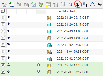

Am I missing something or does dm_overwrite_contents_on_update actually do nothing for me?  The description states: 'Yes: Windchill Workspace Update will overwrite locally/modified out of date objects with the ones in the server. No (Default): Windchill Workspace Update will update metadata only.', however I still get anything modified locally only updating the meta data unless I change it to overwrite.  We are seeing a lot of overwritten data recently.
Creo 7.0.3.0 / WC 12.0.2.1

After more digging thru articles, I finally found a setting that does what I am looking for.
The issue is on the Windchill side as I am managing the workspace from the in-session browser.
This is a change to the Windchill settings: Quick Links > My Settings > Preferences > Workgroup Manager Client > Update Overwrite Local Content  - Change to Yes
After some trial and error, I found that dm_overwrite_contents_on_update controls only the process when using Creo menus to update a file.  If using Creo menus to update does not do a very good job of warning you that the CAD data is not updating, only the meta data, if dm_overwrite_contents_on_update is set to No.
I now have both set to Yes.

I would like Update to default to download all files, unmodified and modified.  Currently it is up to the user to change modified files to download by checking the box and selecting the download button.  I have not seen any problems with updating as long as everything gets set to download.  But, it only takes missing that step once to cause problems.
If I don't get an answer here, I will open a support case since it is not working as described.

Hello @kdirth and @Patriot_1776
Good to hear you found the way to drive the Update process as you want. Relmated to this discussion, but also enlagring the scope for a better explanation:
  • Usually, config.pro options drive behaviors of commands launched in Creo Parametric user Interface
=> Hence the reason why dm_overwrite_contents_on_update takes effect when calling Update from Creo Parametric menus, like RMB in Model Tree OR >File (in Creo) >Update
  • Behaviors driven by commands launched in Embedded Browser of Creo Parametric are however driven by Windchill Preferences
=> Hence the reason why > Workgroup Manager Client > Update Overwrite Local Content preference takes effect when calling >File (in Embedded Workspace) >Update
Also, just for information and future reference is needed, we document the full Update capabilities (From Creo versus from Embedded Browser) - and different scenarios to better illustrate what's going on in some specific situations - in article 292035.
