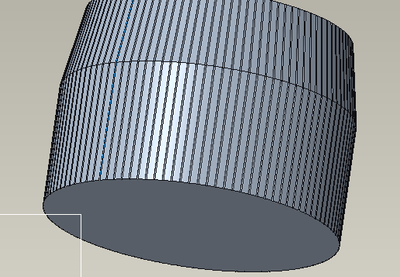

I am trying to create an extrusion on a side of a plastic cap that is on an angle approximately half way up. It is a detailed serration that has a radius of .016 deep and a quantity of 106 around the perimeter.

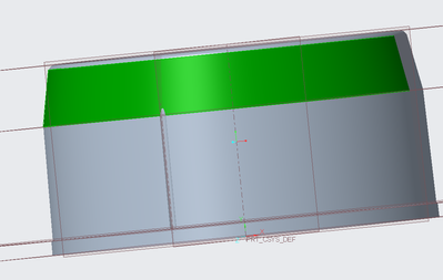

This is the surface I am having trouble extruding a serration onto. The lower part of the surface I have a serration established and now I need to add one one directly above it so it can be patterned to 106 total around the outside. I attempted to use the plane at the beginning of the angle and add a taper to it and no luck. Thanks, Fred.

What I mean is when I extrude from the horizontal plane that is created, is there a way to follow the angle on the outside?

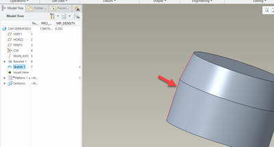

Took me a while to find the serration. I think you will want to make the serration as a sweep feature so the one feature goes top to bottom.
I sketched a curve using a silhouette of the cap.

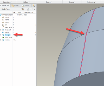

Then created a sweep cut using the curve to define the trajectory.

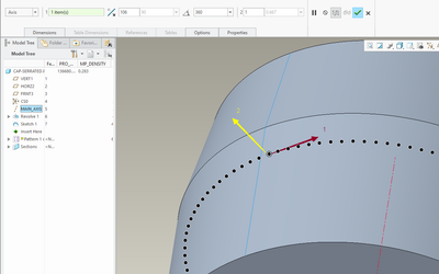

Then I patterned using axis pattern 106 times around.
Not sure this is what you are after but...
Stephen, this is exactly what I needed to do thanks, Fred. Have a good day.
