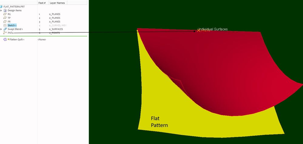

I had created this simple part by using swept blend, but unable to generate the flat pattern. any suggestion to do so?

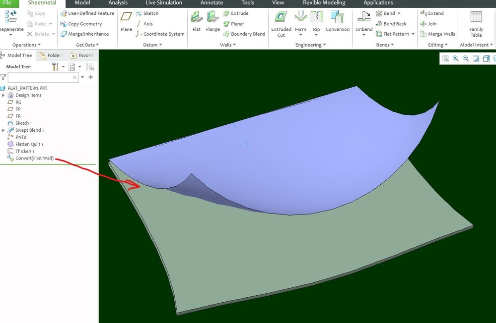

yes, I created that surface in a part. You can possibly covert the flat pattern to a sheet metal part:

You can use the command "Flatten Quilt" . Create an orflatten.jpgigin point as shown and the flat pattern will be created:

Let me correct my self. It is not a part it is a sheetmetal. And sorry for the confusion.
