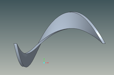

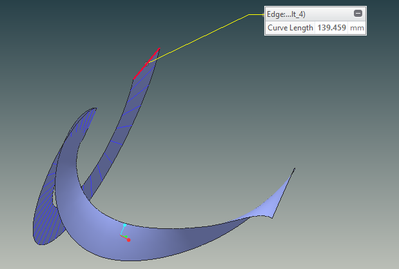

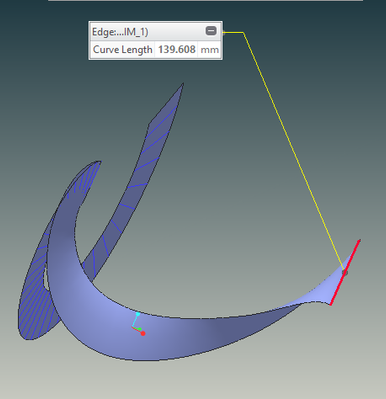

I modelled flight screw in CREO parametric with variable pitch it has revolution of 810 degree. for manufacturing purpose I need to flatten the screw flight. I tried full flight screw to be flatted by using flatten quilt, it failed, again I tried to flatten first 360 degree it was flattened but I did not get exact dimension in flatten quilt. is there any way to do the model in sheet metal or part modelling I attached image for your reference. I did not  get exact dimension it differs with flatten quilt and helical screw.
1.unflatten quilt
2.flattent quilt

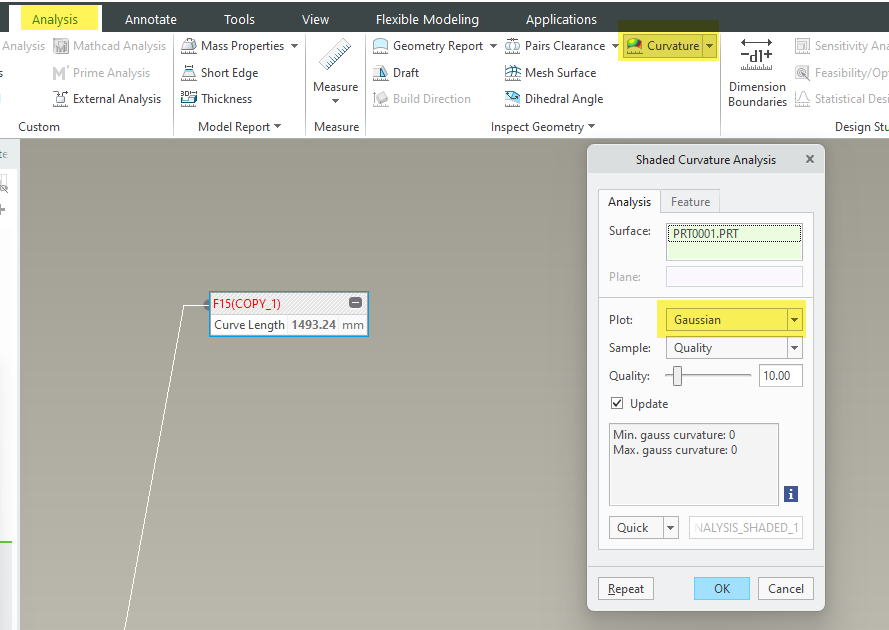

Unless the shape can be developed (can be flattened onto a plane without distortion) in mathematical terms you will not get an accurate flat pattern with any of the Creo methods, and it will not flatten in sheet metal unless all surfaces can be developed.
There is an easy way to check this requirement, analyze the Gaussian curvature of your surface. The surface must be continuous and have zero Gaussian curvature over the entire domain.
