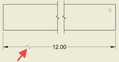

can someone please help me to figure out how to add a zigzig foreshortened liner dimension.

nope, not the witness/leader line, the actual dimension line so that it matches the foreshortened view (broken view as creo calls it)

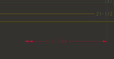

Everything I have ever done with broken views creates the dimensions as if they are normal. I have, in the past when the dimension was confusing, just deleted one of the witness lines so the dimension would show with double arrows (example below)

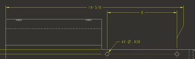

however as a work around how about adding a custom symbol and snapping to the dim line using a snap line. if you move the dim you just need to be diligent and redo the snap line and symbol position.
the symbol is almost correct apart from the horizontal line thought it.
i've tried making the line weight heavier and colouring it white but it still shows when you print a pdf.
any ideas how to get rid of the line or do you think its good enough?
