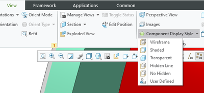

The answer depends on how the appearance of the component in questions was changed. When you open the part in question in part mode what does it look like? You might have to change the appearance in the part. If you have set the component to be transparent in assembly mode, then you can just revert to the default display style assuming you have not modified and saved it.
Check the display styles available in the assembly and see if using one of them resolves the issue. If not, then check the appearance of the component in part mode.
You also have direct control over component display in assembly mode using this element of the UI. If this is not working then you need to provide more information.

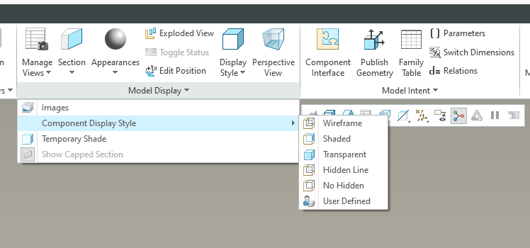

I'm referring to using the "activate" tool in the model tree, which will allow me to edit the selected part's features. There is a setting that disables transparency in Appearance->Model Display under "Shaded Model Display settings", but this also disables transparency in "component display style"(in your first screen shot).
I am still not clear on what you are seeing. I have made a guess on your latest response. I am following your command sequence in Creo 9 (maybe it has changed in Creo 10). I am not able to find the below sequence which you noted in the previous post:
When you activate a part in assembly mode you will not have access to the component display style command which can only be used in assembly mode. See the below example of activating a part in an assembly. If this is what you are experiencing, then it is not an error or bug. When in part mode there are no components available for selection.
Note that temporary shade is available.
Screen shot from Creo 9 with a part activated within an assembly and my best guess at where you are in the UI. if this is not accurate then please clarify exactly what you are seeing with screen shots and command sequences.

The quickest way is to use the mini-toolbar - that pops up when you click on the part, with two commands - transparency and component display style
