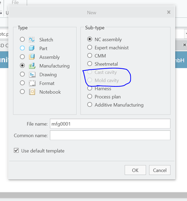

how to enable an option of mold cavity in sub type in creo 9.0
VC_10904688
2-Explorer
how to enable this option in creo9.0
1 REPLY 1
tbraxton
22-Sapphire I
(To:VC_10904688)
You need to have a mold design module license to access the mold and casting subtypes.
