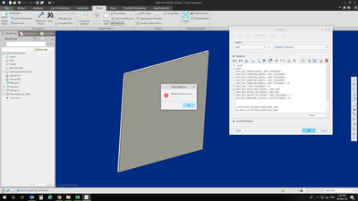

Its a old post, though if you are still active on this community, would you help me out further more on this topic. We are using Creo-5 . the issue is with the same topic that i need the Length, Width & Thickness in my BOM when i extract it.
Since i Am new to this relations and parameters. can you kindly help me create a relation.
i followed your screen shot and gave the relations. but its giving the following error. And how do i relate this with the parameters??
It would very nice of you if you elaborate furthermore
kindly help i would be grateful to you
