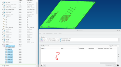

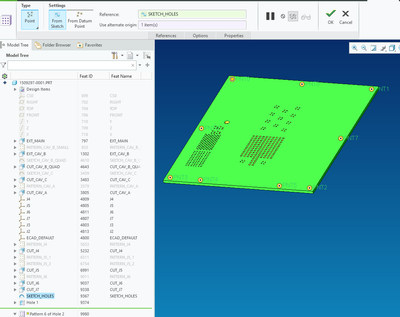

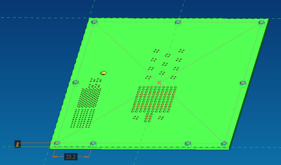

If the pattern is done from a sketch of datum points can you still pull the quantity somehow for a drawing callout?  I'm not finding the 'p#' parameter to use.
The pattern is not regular, so I need to use the sketch points.

Yes, patterns and sketched-layout hole features have a feature parameter called PTC_ACTUAL_PAT_MEMBERS:
for example:
GB_10534440
(To:pausob)
If I'm not seeing any parameters associated with the hole or pattern does that mean something else isn't set properly?
Maybe it has to do with me being on CREO 8.0.0.0?
My holes are 'simple' through holes.  Does it only work with 'standard' holes?
pausob
(To:GB_10534440)
yeah, sorry... sadly, this functionality is for Creo 10 and above.
