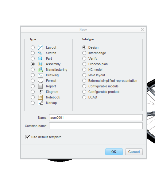

how to get instrumented option at the assembly? I have installed CREO 3.0, and also cofigured schools extension. do we need higher version of creo to get that option. thank youinst.PNG

please explain the term "instrumented assembly".
Martin Hanák
I'm sorry. I meant to Integrate sensors to create a 3D model sensor
network. In assembly options if there is instrumented after Ecad then in
the tools ribbon bar we are able to add sensors
guess no.1 ... sensor functionality was introduced in Creo 4.0
guess no.2 ... sensor functionality is available when special license is available (I think it is not present in Creo school licence)
