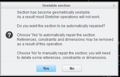

Any idea why I can not constrain the large radius to the point in the center a the 0.005"?
file is creo 2 m250
thanks!

Typically a failure of this type is a lack of available precision. You can try to change the range by setting the accuracy to absolute (if that still applies to the creo version) and use a value like .002.
You might also just use larger values in the sketch and edit them afterwards. If it's an accuracy problem the feature will fail to regenerate and you can try other values to sneak up and chose a useable accuracy value until you get what you like.

The values in the original picture have radius is 1125, one offset is .005, other offset is .008
Resketch with the following changes:
1125.___ -> 100.0 in the sketch
.005 -> 5.0 in the sketch
.008 -> 8.0 in the sketch
This will change the ratio of feature control
from 1125:.005 = 225000
to 100:5 = 20
making it easier to solve with whatever accuracy there is.
You really haven't said what fails. What is the exact error message?

It doesn't "fail", but it doesn't allow the radius to be constaint to the center point. See the radius dimension is blue, I don't even want that as a dimension, I want it defined by the constraint. It SHOULD do it from a geometric point of view, as you can move it there free hand (and be really close to correct).

If Creo sketch manager is adding that dimension it's because there aren't enough constraints otherwise. If it then fails when you add another constraint then it's because it is overconstrained in some way.
To understand what sketch manager is assuming I usually draw the feature in a very exaggerated way until the dimension method (not the values) and the other constraints are what I want and then start changing values.
It is sometimes useful to add control geometry, such as a point which gets constrained and dimensioned and then use 'coincident' to drive later sketch features so that the constraint manager has a more direct path to solve the sketch. That way you understand what places the point(s) and can see that they behave correctly.
I don't recall a time where the sketch manager was wrong about missing constraints, but I have had times where it would make assumptions I didn't like. If sketcher manager is adding a dimension or other constraints (the center of the arc is very far away and you need to zoom out to see the contraints on it) then it's because they are required to fully constrain the sketch.
Now that I know it's a constraint problem, I would make the radius value Strong and then change the value from 11xx to 900 and see if something moves in a way that is not expected, indicating a constraint you want is missing.

before you start editing definition of Sketch 3 feature in large-rad.prt.5 model, you must temporarily change value of d19 dimension. This dimension is related to Datum Point if 102 feature. Modify its current value 0.005 to 0.1 and regenerate. After this modification, you will be able to edit definition of Sketch 3 feature, because sketcher will be able to solve shape of section.
Please do not ask me why sketcher is not able to solve shape of section in case that d19=0.005 . You can open Case at PTC Support and ask PTC :).

I think a fairer message should be "solution method has become numerically unstable." Creating sections requires creating a numerical solution to the constraints problem and it's probably the case that there is insufficient precision in the math to manage an arc that is very nearly equal to it's own chord. I expect the PTC developers have an instrumented version of Sketcher to see what the real failure is, but that may not lead to a fix if it requires significant other changes.
Manually creating a solution and using Curve by Equation (a spline instead of an arc) might be OK, or it might go poorly for the same numeric evaluation reason.
