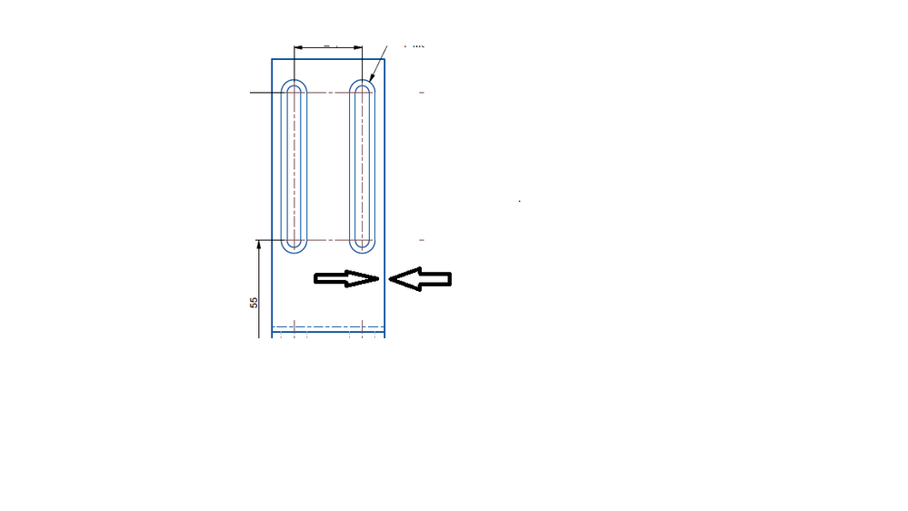

when we are going to export the drawing into the pdf the line weightage is increased. we are unable to find where I can reduce the weightage of that line.
is there any setting in Creo where I can reduce the thickness of the line or weights. demo.png
So' help us to out us from this issue.

Pen tables and plotter configurations can control this.
To Change Plotting Pen Attributes (ptc.com)
