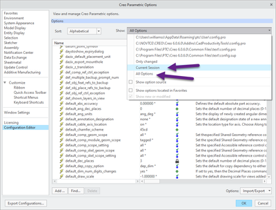

I can't open you files but IF this is only on your computer and not on another computer, it is likely a config.pro option
I found a config.pro option with the same name.
display_tol_by_1000
You need to check ALL config files You do this by going to FILE - OPTIONS - CONFIGURATION EDITOR and then select either CURRENT SESSION or ALL OPTIONS.
if you see the option set to yes, you will need to look at each config.pro or config.sup (also shown in that same drop down list) and change that one to NO

Sandy7
(To:StephenW)
when i restarted creo again and opened again the drawing and checked the display_tol_by_1000 value was set to yes.
as soon as i set it to NO the tolerence value came back to normal 😯
thanks guys. really appreciate it.
