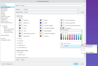

Dears,
I have two questions.
  1. When I am in assembly or part, and want to use option File > Save as > and choose saving type as pdf. Then I get an effect like in attachment. I have a background colour in appearances set as white. Why do i get this navy blue colour as a background in pdf? How can I make it white?
  2. Is there a possibility to make a perspective view on the drawing?
I am using Creo 5.0 M040.
Thank you in advance for any hints.
Robert

I just ran into this issue when a user was attempting to save a JPEG. We were able to narrow it down to the system colors file. Try launching without a system colors file and see if that fixes the issue. I think the issue is related to gradient backgrounds.
@Tdaugherty Moonstone: what do you mean by " launching without a system colors file"?
Most likely, you are pointing to a system colors file in your config file. You can comment out that line or add a new path in your own config to a new file. Kinda depends on how you have your environment set up. Alternatively, switch to one of the default backgrounds in the options menu before exporting your file.
I changed to "black on white" standard System Colors and exported it to my own Syscol file in my config directory.
Closed Creo, opened again with a "new" Syscol but still cannot export it without this gradient. 😞
kdirth
(To:Robert_K)
I does appear to be a gradient.  In Options, select No Gradient.
Thank you for your replies. Unfortunately it seems that it is not the issue. I do have "checked" no gradient box and it still appears as in my pdf.
Is there a possibility that it "bites" with some other command?
Based on my testing, I don't think unchecking that box solves the issue. You need to actually launch with a clean system colors file.

Hi D. Nordin,
I could find in the configuration only "enable_opengl_shader". See attachment.
Unfortunately changing to "no" didnt help.
Br,
Robert
