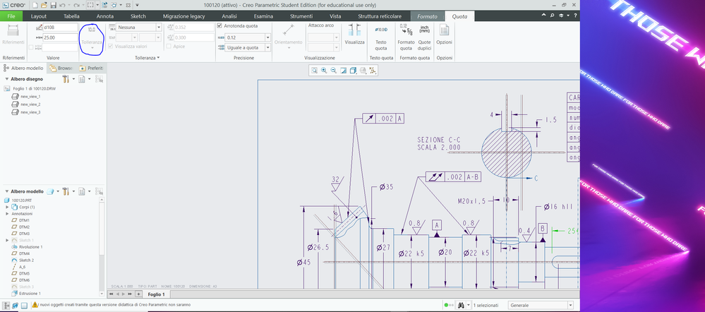

the tolerance feature in unactive. as you can see i can't choose the type of tolerance in the feature in the blue circle. This doesn t allow me to change the tolerance. In the part i can, but in the draw i ve this problem. i tried to change tol_display in "yes" in the editor configuration but nothing changed. please help me.
Solved! Go to Solution.
you have to turn on display of tolerances in drawing, too. See uploaded video drawing_tols.mp4.
You can save Drawing options into the file with .dtl extension and reference it in config.pro option using drawing_setup_file option.
Creo copies .dtl file into every new drawing. In existing drawings you have to load specific .dtl file manually.
