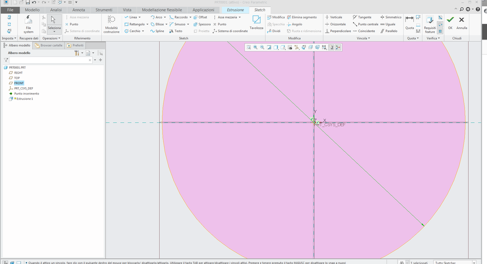

Good morning, I am now a user of Creo 5.0, I wanted to know how to have an automatic zoom display. By executing the classic diameter I would like to identify the whole screen, this does not happen. Is it a setting problem that I can not find in the Options?

If I understand right, you looking for this config. pro option:
sketcher_refit_after_dim_modify

yes
