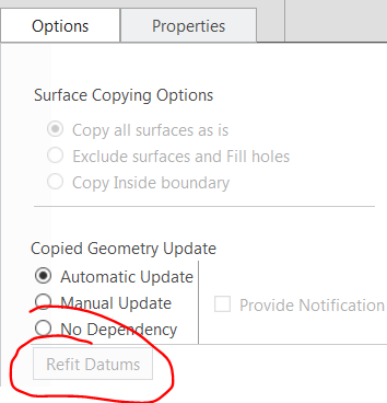

on a related note.  Creating new parts using top down design with the default location sometimes means that I have planes that are located away from the actual geometry I'm creating.  I can edit the plane features and resize/reposition them, but I cannot automatically fit the planes to the geometry if it misaligned or outsized.  Are there any methods for forcing datum planes to refit themselves?

In many data-sharing features options, there is often button for "Refitting datums"; maybe it does what you want?
