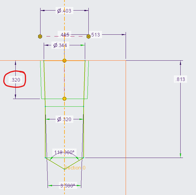

The cosmetic thread length on tapered standard hole features is editable in Creo 9.0.
Before: (.273)
After: (.320)
The length (depth) of the tapered section is also editable while the 'straight drill' is set to none.  Just turn it off, edit the length, and then turn it back on.
