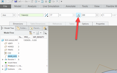

I am using Creo Parametric - Release 7.0 (connected) 7.0 7.0.4.0
pattern using axis to fill up certain angle is gray out
how to fill up 300 degrees with 17 holes?

this symbol is gray out I can not use it
that's why I did open this case

To change to fill up, click the angle button shown below

I don't understand what you mean. It's a pattern about an axis, so you need to have an axis. Do you mean in Creo 7 you need to create a *new* axis? That would be an odd change from the standard behavior.
The reason I did created this case its that I was trying to use existing axis and this option(pointed by red arrow above) was gray out so I do not understand why I can not create such function in Creo 7 which seems to be basic function

Did you figure out what the problem was? You have to select the axis of rotation before it lets you choose the angles or pattern qty.

Click the button that looks like an angle dimension. That's how you toggle between a defined angle between holes and a fill the angle.

Click on the angle symbol kdirth_0-1638807153967.pngthen change the total angle.

I make it works - what's a silly staff
the funny think is that you can not change it either delete pattern and start all over again or not

360 degree is gray out but if you click angle sign it changes - what a stupid idea

Your screen shot shows the angle value grayed out but the symbol is not.  Click the symbol to switch to fill mode and the angle value will not be gray.
