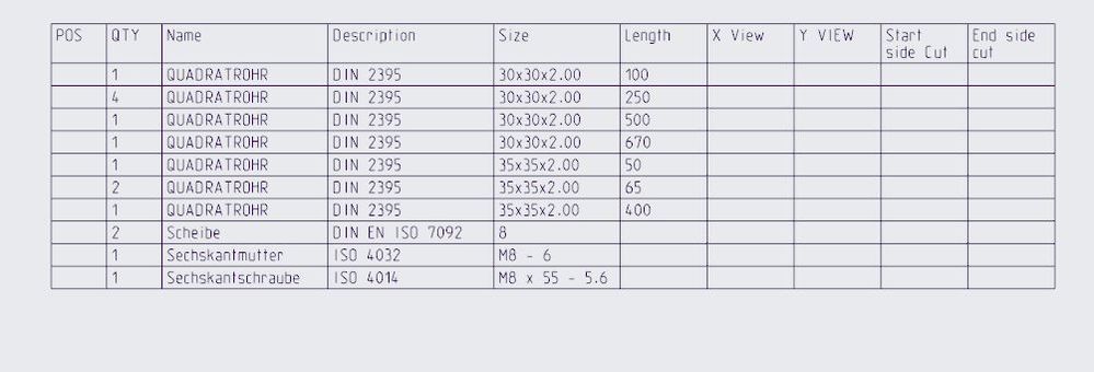

I've created a framework consisting of some steel-tubes that are cut in an angle on one or both sides
Now I want to create a list (BOM) of all the Tubes that have to be cut. I created a BOM and got the length of the profiles by using the parameter "asm.mbr.length". Also I got the cross-section by using "asm.mbr.BUW_SIZE".
Is it also possible to get the cut-angle of the profiles ? I didn't find any parameter for it.

I just wrote a blogpost about this here: https://www.buw-soft.de/en/2019/08/08/cut-angle-information-in-bom-parameters/
You can download the attachment and follow the instructions in the readme.

Thanks a lot.
I've downloaded the table-files and it works very well. The cut angles are displayed correctly.
Only one thing doesn't seem to work: The first column of the table(asm.mbr.EXF_ITEM_NUMBER) is empty. What do I have to do to get this parameter into the part ?

Hi @MaikTheBike ,
here you can find the description about AFX item numbers:
https://support.ptc.com/help/creo/creo_pma/r6.0/usascii/#page/advanced_framework%2FTo_Create_New_Item_Numbers_for_all_Models.html%23wwconnect_header
If you want to use the creo standard you can set the repeat region parameter to rpt.index

Hi Sam,
Thanks for your help.
Now the item-numbers and the balloons work perfectly.
