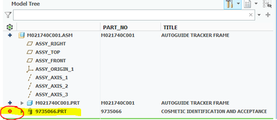

we are using Creo 6.0.6.0 and Windchill 11.0 M030-CPS16
seeing issues with server status on "locked files" - Creo server status shows "modified in session"

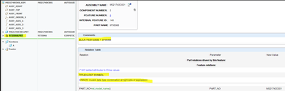

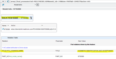

issue with lost symbol - PTC_COMMON_NAME in component (part) relation TITLE=PTC_COMMON_NAME
assy feature info. shows lost symbol
part file info. shows no issues
any ideas why this might be happening
