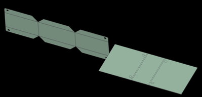

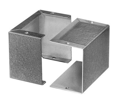

1.  Simple Sheet Metal Parts fitting together within an assembly  *Sheet Metal Enclosure
Features: A single flange with a few holes and simple reliefs. Ends in a clean flat pattern.
A great starter part for beginners: focus on flanges, corner relief, bend, and flat tools in Creo Parametric.
The flat pattern view verifies it regenerates and flattens perfectly. A secondary challenge for this assembly might be to ensure the parts always puzzle together. Change one Skel part and the piece parts update. For example I might use top down design skeleton part to drive the two geometries.

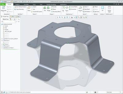

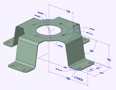

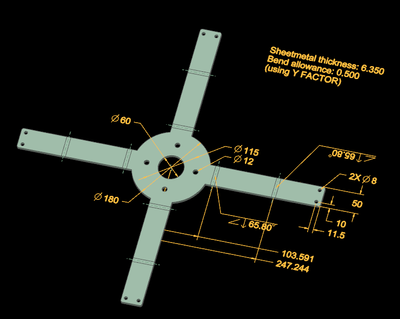

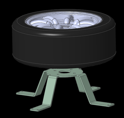

2. Intermediate Part  *Spare Tire Mount
Features: Multiple bends, unbend/bend operations, holes in patterns, notches. At the end, the model is flattened. Include drawing annotations showing material thickness and bend allowance, essential for manufacturability. This level demonstrates real-world practices: planned bends, hole patterns, and overall intent. The pattern on this part may be more challenging that at first understood.

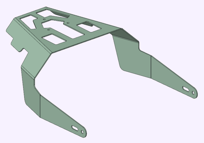

3. Complex Housing Assembly (Single Sheetmetal Part) *Aluminum Rear Seat Support Cowling
Features: More walls, cutouts, tabs, notches, perhaps light louvers or stiffeners. Shows the full power of Creo’s Sheetmetal flattening. This type of part highlights how Creo handles intricate bends, and flattening over complex geometry without errors.  There are a number of methods for approaching all geometries including this one.

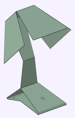

4. Extra Credit: Multibody Sheetmetal with Flat Assembly Export *Desk Lamp
Showcases Creo 11+ multibody Sheetmetal capability: multiple bodies in one part file. One might apply Boolean, split, or trim operations between bodies, create independent flat states, and manage everything via the Flat Pattern Manager. Great for advanced users: assemble layered components or hybrid configurations, then generate individual or assembly-level flat patterns using the multibody workflow.  One challenge is to have the geometry flexible for changes in front of marketing & have the sheet metal part be laid out with one sheet metal part. Another challenge may be to establish the flattened state onto  a sheet so not to be wasteful of metal scrap.

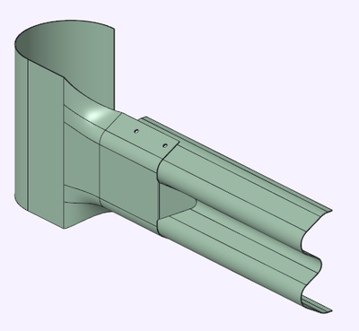

5. Extra Credit: Multibody Sheetmetal *Guard Rail
Showcases Creo 12+  This particular guard rail design helps slow a moving vehicle with the crutch factor.  Consider using Mulitibody can be helpful to maintain proper hole alignment with the two parts.  There are other challenges in this assembly that you will notice as you try to create the geometry.

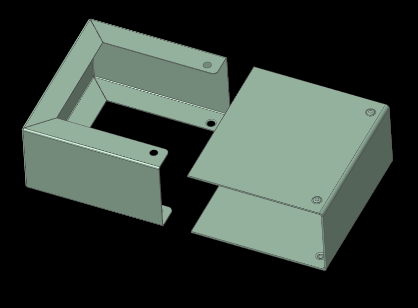

Here is my submission for part #1 done in Creo+.
bbrejcha
(To:kdirth)
Exciting kdirth!   I tried to look at it but I'm in Creo 11 at the moment. You must Be in Creo12.0  did you use points or sketched lines to get the holes to line up?  Sketched lines are how I teach people to do it the past few years.  Does it flex w/out fail?  Ill dig into it tonight.   Im hoping you try some of the others.
bart brejcha designengine.com
kdirth
(To:bbrejcha)
Used a skeleton to define the outside.
Holes were a bit of an afterthought and location could have been included in the skeleton.  But they are tied to a plane and the outside of the skeleton.  This was my first time actually starting with a skeleton model.
I have not flexed the skeleton, but believe is will not fail.
You will also see that I provided some clearance to account for a small amount of manufacturing tolerance.

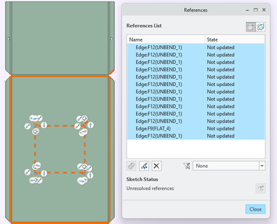

So, I did try to change the dimensions and had issues with the references updating.
I changed the constrain scheme a little and it now updates if I enter the sketch and update the references.  I did not have to change any of the references, yet I still had a failure due to the dimension change.
I have seen this issue many times since we updated to 7.0 and is obviously still an issue in 12.0.  Are there any settings that I can change to get Creo to update the references without manual intervention.

OK, last submission:
  • Lamp one version out of single piece of sheet and one in two pieces later is also more robust for easy modifications
  • Guard rail built for modification.

Here is my submission for part #2 done in Creo+.
Patterns were a bit difficult in sheetmetal.  I found that it worked best for me to create a leg to pattern then join all 4 legs with a planer.

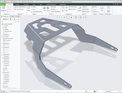

Here is my submission for part #3 done in Creo+.
As @tbraxton mentioned earlier, starting in sheetmetal is not always the easiest way to create a sheetmetal model (and capture your design intent).  Here I started with a surface that I thickened and converted to sheetmetal.

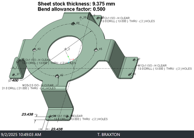

#2 Spare tire mount geometry
Using sheet metal mode is often not the most efficient method to create geometry in Creo Parametric. Many geometries are more readily modeled in part mode. All users should be aware of the option to convert models to sheet metal parts.
About Converting to a Sheet Metal Part or Body
Creo 9 model posted. This model uses part conversion to get the flat pattern in sheet metal mode.

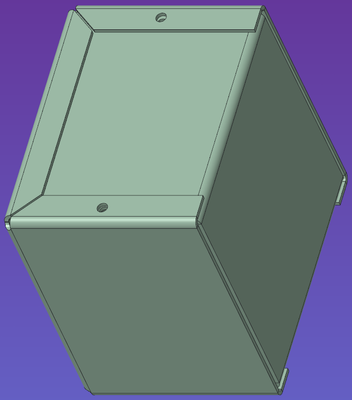

Here's my go at Problem #1
(mostly) everything is defined by the sketches and parameters in the 1st half.
The model seems robust to changes, although multiple regenerations are required if the sheetmetal thickness is redefined.
