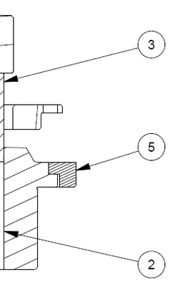

Thanks for the heads up on differences. One thing so far, how do keep a number centered inside a balloon when "Saving As"
Saving As
Printing

I use "stroke all fonts". It usually gives a better looking PDF.

Just realize that the PDF file size can increase significantly by stroking everything, especially if there are large tables or repeat regions with lots of text.  My preference is to only stroke non-TrueType fonts.
