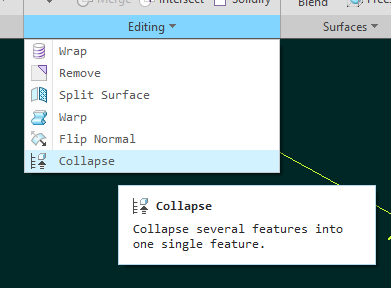

I am using Creo Parametric Release 6.0 and Datecode6.0.4.0
1. When using a surface from an another model, when you copy and special paste through the assembly
You can paste that surface into your model, how can you keep the model you're working on and the model you copied the surface from referring back to that surface that you just pasted in to use as references for a new part. if you right click on it and say exclude or permanently delete all references the model that you created from that surface still goes back and looks for that surface and gives you errors. how do you keep your new copy and special pasted surface from ever being referred to?

For (1), I'd say the easiest is probably to open the part, select the copy feature and then use the "collapse" function to turn it into static geometry:
pausob_1-1675285135494.png -->

To provide some context to the solution offered by @pausob , see this link.
How to use collapse geometry:
https://www.ptc.com/en/support/article/CS59684

Another option is to use an external copy geometry (not paste special in the context of an assembly) and set it to be independent.  The advantage here is that you have the option to reestablish dependency going forward if it is needed.

To build on @tbraxton suggestion of using external copy geoms -
if extern copy geom is set to be completely independent (no dependency) then the link to the original is severed and cannot be re-established.
If set to be "manually updated", it will not auto-update if original changes - but the dependency remains.
IMO, if you are going to use the "no dependency" option then the copy + collapse method is just faster.
