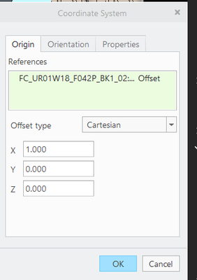

so i just replaced a outdates part with something new that wasn't "relate" in creo now all the coordinates I made that referenced to the old part are still "working" but they are locked and im unable to redefine them. when I select the edit it shows the old reference with a yellow circle saying access locked and the reference is not found.
I'm not sure how to fix this I've tried changing the path or forcing a redefine but it doesn't work. and i cant select anything different either.

so originally I had created a coordinate based on the part coordinate but moved slightly. when i replaced the part, the coordinate I had based mine off of still exists but its moved slightly. instead of rerelating to the new system my coordinate doesn't move.  when i open my coordinate and tried to change the reference i am unable to. when i right click and select what's wrong it says access locked and i cant delete the former reference or do anything to my cordinate.

sadly i cant do either sorry i know its confusing im trying to make it make sense. here were my steps.
i have a part with a cordinate system in it related to a hole.
i added my own coordinate system to that 1in out so i can relate other parts to my coordinate system.
i then replaced the part in the assembly and the hole in the part with the coordinate has moved slightly.
my coordinate that i created and all things related to it are still in the original position so when i go into the system to see this screen
instead of being able to edit its reference i have the name with a yellow circle and when i try to change the reference i cant select anything and right clicking on the reference says reference locked and doesn't exist. so i cant change the reference or delete it or replace it or change the path to fix the broken one.

When I did what I think you are describing, the coordinate system I created simply failed and I was able to redefine it.
Can you RMB on the coordinate system ande select "edit references" or the chain link icon (not sure how it was in creo 4)
You may have to create a new coordinate system (delete the old one) and then redefine all your part to be related to it instead of the old one.
I'm trying to hint around at possible things. I don't remember ever seeing anything that said something was locked.
Can you include a screenshot of where it is saying its locked?

im going to try and see if i can but i cant replicate my problem either im not sure whats causing it
