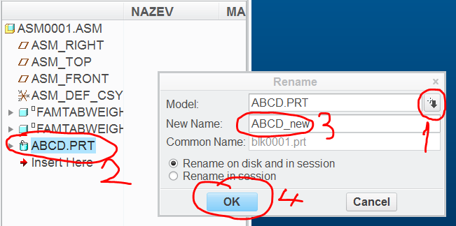

in Creo 2.0 in Assembly mode you can:
  • click File > Manage File > Rename
  • now you can use following dialog box to rename bulk item

Creo 4 does not allow you to change the name of the file you are renaming. It will only allow you to rename the open file. Unless there is a config.pro setting I do not have enabled?
I decided to do it the easy way, since I had 3 assemblies that needed the renamed file. I copied the file on disk and renamed it. I opened each assembly and added the new named part and deleted the old part. Being bulk items, there is no positioning to worry about. It just put the bulk item at the end of the model tree.
