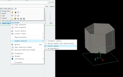

Why not just set the update control for the copy geom feature to "No Dependency" ?
Michael_
(To:pausob)
I want to update the model such that the references are all set to the new surface which will be created early on in the model.

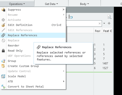

pausob
(To:Michael_)
Try inserting your replacement quilt right after the copy geometry feature.
Then select the copy geometry feature, and use the "Replace References" tool:
Replace the references with the new quilt.
If successful, you can then delete the copy geom feature as all downstream features will use the new one.
Michael_
(To:pausob)
The edit references option is very interesting - while it proclaims to have removed all the references it still leaves the features attached in that if you try to suppress the copy geom after you've replaced the references it wants to take the other features with it.
