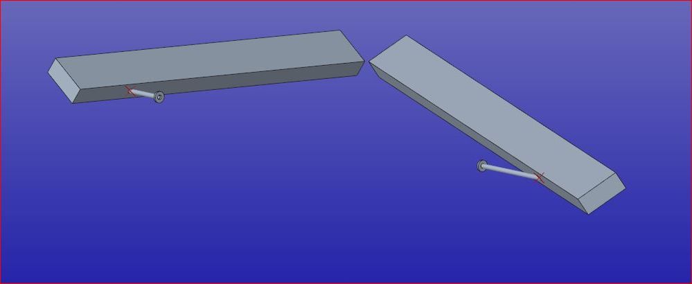

I need help solving for the cuts and constraints for these pipes.
I just can't quite figure out how to go about laying out the parts to make the cuts.
I need to start with just a regular pipe and do part level cuts, then assemble them.
what is the process for figuring these out.
I wll attach the layout part and some pics that might help explain.
I want to do this with out assembly level cuts.
 here are more images
I have a working skeleton model I just want to lay out piece details and the orientations

I dont see any pipes, just solid bars and bolts..?
Not sure what you want but maybe this helps:
For example when I want to fit pipes together I first assemble them so they interfere and then do the following:
Model --> Component --> Component Operations --> Cut Out:
First select the part you want to cut, then select the parts that stays in place and Creo automatically creates a Merge/Inheritance of the part that stays inside the part that will have the whole first part as a cut-feature.
Remember this only works when the assembly will stay together..

No bolts just to square beams that have a flanged pipe brace between them.
I am trying to do this so I can lay it out for the shop

I admit - based on your powerpoint slides and from the messages in this thread, I couldn't figure out what you are trying to do.
I guess you are trying to make a miter cut in the pipes so that you can weld them to the square tubing such that when you bolt the flanges together you will have an L shape made out of square tubing and braced with the flanged pipe?
Anyway, here's a link to a youtube video where in its first segment, Leo Greene shows some neat assembly techniques of getting this kind of thing done.

I am still not sure where your problem is.  I assume it is because you don't want to do assembly level cuts.  I'm not a fan of them either, so here is one way of a part model that has external references.
1) Assemble your pipe segments in the assembly - in their final location.
2) Activate the pipe component.  Then switch the selection filter to "Geometry".  Select a face of the rectangular duct to which that pipe will be connected.  Then right click and select "Solid surfaces" icon (it's a cube, I think).  This should collect all the surfaces of the rectangular duct model.
3) Press CTRL+C, then CTRL+V (copy, paste).
4) Open the pipe part now.  There will be a copy feature in the model tree.  Select it, then execute the "Collapse features" command on it (I don't remember where it is - Engineering sub-menu, I think - I suggest you just type "collapse" into the command search box in the upper right).  So, this step will turn the copy feature it into a static independent geometry feature which you can then use within the part to make the cuts you need.  If the duct model is an enclosed volume, then a single "Solidify" command should do the trick.

Thats a tedious version of what I proposed
psobejko
(To:bp)
Well, yes.  There are many ways of skinning the cat 🙂
I realize now that you can break the external references in the "cut-out" features and thus create a stand-alone model.
