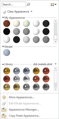

Yes, it was my initial idea, that the colors had to be configured somewhere in the .scl file.
But as it turned out PTC changed the "default.dmt" file. If anybody else is having the same issue and you want to change the "uncolored" solids and sheetmetal, I attached a screen.
