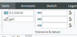

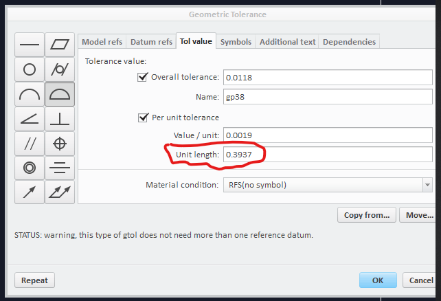

See the image below.  It's the "Per Unit Tolerance" check box.  I'm trying to apply a tighter flatness tolerance to an area of a part.
How do you do below in Creo 4.0 and up? Below is from Creo 3.0.

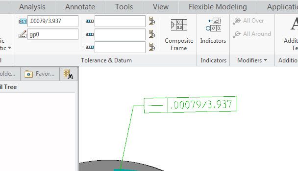

Thanks!
I guess what the customer has is wrong. Because Creo is more up to date with standards, GD&T is more controlled. Per unit basis not compatible with profile geometric characteristic.

What version Creo 6.0? It works for me, I have Creo Parametric 6.0.5.0.
RCorley
(To:SkyKing)
Thanks for checking.  It's Creo 4.0.  It works on another drawing/model I have.  It just doesn't for this one.
