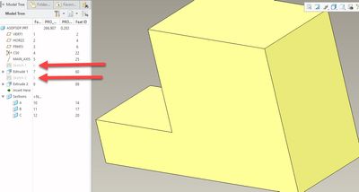

I am new to Creo, but have worked with many other CAD software. I am attempting to blend two surfaces together that are offset by planes, but I am unable to view either of the sketches. I seem to only be able to view sketches when I have the explicitly selected, but they appear as if they were hidden when unselected. I have the sketches  shown in the tree, however they appear hidden. I can create a 3D part, but cannot view the 2D sketches unless I highlight them.
Thank you in advance!

It may help if you include a screen shot.

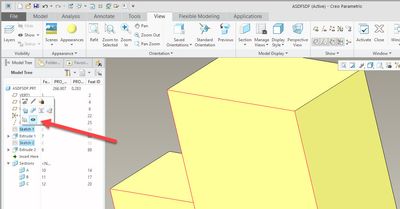

I think you may be referring to external sketches that Creo automatically hides when you use them in a feature. If so, simply RMB on the sketch in the model tree and use the "show" icon.
