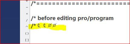

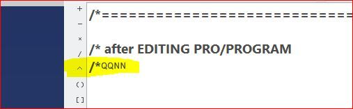

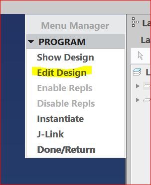

Yeah it's as soon as you click on edit design when you are editing the pro/program
It does a few undesirable things.
1- truncates lines and makes them unable to evaluate (although the relations still calculate fine)
2- it also capitalizes all the text. So Part_Length changes to PART_LENGTH
3- Changes most* symbols, from "text symbol", back to its letter value. (see below images)
