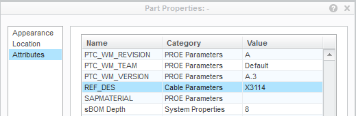

Is there a way to point my customized callout to the ASM instead of the PRT? The connector number metadata that I'm attempting to target is in the ASM (highlighted in structure) and not the PRT. Please see my annotation and screenshots below.

No, I don't think so.

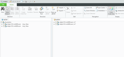

For not going back and forth from Edit Structure tab, you can add the same model to the file and one of them will be with combining parts and another not. This will cause that the file will be more have so have this in mind.
This won't work well.
You can't link the same model two times. If you want to do things once and never go back, you could do that. But otherwise you'd have to maintain two exactly the same models in Windchill with different name/number, do twice the work for each update, etc.
The only way to create callouts referencing different levels of assembly attributes is by editing structure and combining children, then creating the callout and editing the structure to reverse combination operation.
I'm not sure if this is true:
"You can't link the same model two times."

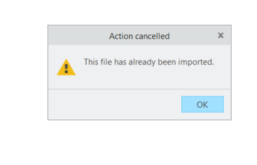

For me it works.... of course you have to do this via "import" in home tab.
It might work if you copy the file - create two separate pvz files. Unless there's some kind of option I'm missing...Which version are you on?

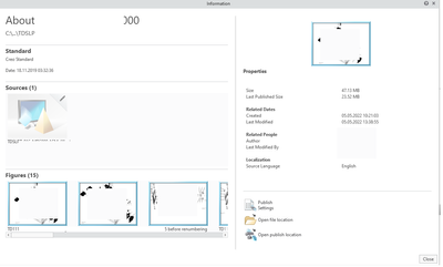

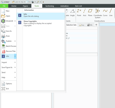

You can also removed attached file here:
and then this window appears:

Currently the assembly node must have geometry for a callout to be created at that level.
