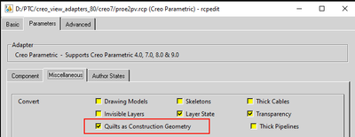

Allright, I solved at least portion of problems. Construction surface geometry is by default turned off in Creo View and Illustrate. For some reason all imported geometry is treated as construction so turning it on in options makes it appear...
The mystery remains why exporting PVZ directly from Creo makes this geometry a "normal" surface geometry visible in both applications...
vdegaonkar
(To:TomM)
Hi Tom:
Seems like your Creo Data has quilt surfaces (usually comes as part of Import Feature in Creo Parametric). By Default Creo View Adapter converts quite surfaces as construction surfaces which are not visible by default. You can control this behavior using recipe option show below. Un-check recipe option Parameters >> Miscellaneous >> Quilts as construction geometry option and then republish you windchill CAD documents. Please make sure you have a visibility control defined on undesired quilt surfaces using layer so they wont be visible by default in Creo View output.
In Creo Export to PVZ workflow, this option is by default un-checked in respective recipe file.

Hi. I have it off, although I'm not sure at which point I changed it, if I did. I'll be looking into these things in the following days/weeks. I have to put it aside for a moment.
