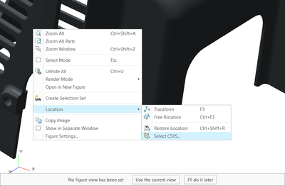

The option to set the rotate axis has not moved.
You will find it in the RMB menu under Location (note that Transform needs to be active):

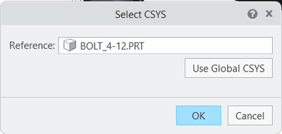

This allows you to pick a part, edge, axis etc to use as the csys (rotation point).
Hope this helps.
