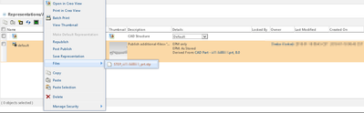

This is where you could leverage the Windchill WTPart functionality or use the windchill publisher to create the PVZ and attach additional files.  (I have the step file shown below...don't know if the windchill publishers can generate 2d pdf the same way though.)  I'm sure I'm not fully understanding your question...but what I've mentioned are two ways to "link" the data together.
