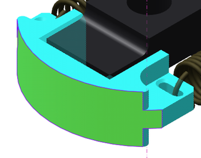

Are you seeing this issue with more than one set of data?
Have you been able to verify that you can select faces on the parts?
The image below shows a selected face:
You can use the selection filter in the right hand side of the status bar to select only faces, this will make it easier to establish if the geometry has enough geometric detail to be able to apply decals.
If you cannot select faces then it is likely that the data doesn't have the necessary detail for applying decals.
