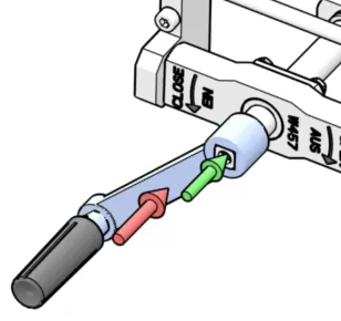

I would like to animate a crank rotation. For this I use the effect Screw Turning.
Unfortunately, the crank turns around a wrong (default?-) axis (red arrow). I would like it to turn around the axis of the green arrow.
I have already tried to select other coordinate systems, but it doesn't change. Does anyone have any advice?

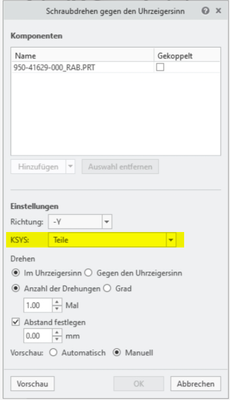

I think the coordinate system area of the Driver Effects Properties menu is a role that specifies only the direction of rotation, not the center of rotation, in a single part.

First, combine the green arrow and the rotary handle to coordinate by the arrow, then record the animation and delete the arrow animation.
I don't know if this is the best way, but it's easy to use.

What I don't understand: In the properties menu of the Screwdriver effect you can set the direction of the movement and the coordinate system. The direction (here -Y) is clear and it works.
With the coordinate system, it only makes sense that this is the rotation point. But no matter what I set, the rotation of the hand crank always remains the same.
So am I misunderstanding the setting for the coordinate system, or am I applying it incorrectly, or is it a program error in the end?

I think the issue is that the unscrew effect is always using the center point of the selected part(s) as the rotation point.
The csys is only used for direction, I think this is where an enhancement is required.
An option to use the csys as the rotation point might be one solution.

Your solution works well, thank's a lot 👍
