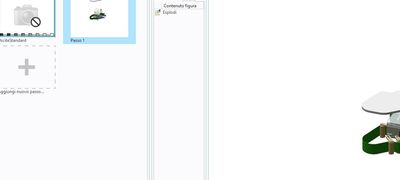

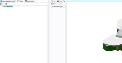

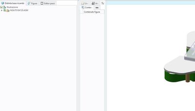

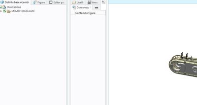

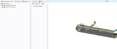

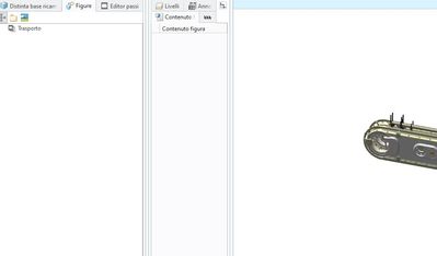

Hi Everyone,
I have a similar question. Can i merge together two animations in an easy way?
I create two different file with two different 3D assembly.
File 1:
File 2:
And then i put this two files together in a new 3D assembly without animations:
File 3:
With the technique of unzipping the PVZ file I put the animation of File 1 and the animation of File 2 into the file 3.
I worked in: 
This thing works and at least I have my animations that works in the new assembly.
But is there a new solution that I can do this type of things inside the program?
The unzip solution in not easy to do in a day-to-day business.
