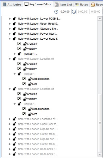

I have an issue with Creo Illustrate 3.0 that is annoying more so than fatal!
After producing any animation which contains annotations, never more than 20 or so annotations per file, I can export the file and save it as a .wmv as usual. No problem.
My issue is that when I go back to the original file, I find that a lot, but not all of the annotations and Markup 1's appear grayed out in the Key Editor. This means that I have to redo those particular grayed out entries if I need to edit the original file. It is very time consuming to have to re-invent the wheel every time I need to edit a file to produce another animation.
I have had some helpful feedback from PTC regarding this issue but hasn't fixed the problem. I was told to rename the User Preference file in the Application Data, which I did, but the issue remains. This is an example of what I am seeing...
Perhaps someone has come across this issue and has a fix? Any help or assistance would be appreciated!

Brian,
I've experienced this also.  Additionally, I have components in my assembly that will randomly relocate and reorient from there originally place location and orientation during animation playback.  Have you experienced this at all?  This is driving me nuts!

Brian,
I've experienced this also.  I was unsuccessful at getting an answer or resolution from PTC for this issue.  Additionally, I have components in my assembly that will randomly relocate and reorient from their originally placed location and orientation during animation playback.  Have you experienced this at all?  This is driving me nuts!

Hi Myon,
I approached the issue from another PTC direction. I am now using Creo Illustrate 3.1 and most (but not all!) of the issues have been eliminated. I had to re-assess the way that I produced animations also because I was seeing the same issues as you, especially with annotations. I find that you have to be very careful in picturing the way that these additional items appear in 3D space. What might look to be in a certain location in one view may suddenly become a very different location when running the animation!
Other functional issues such as the ones that we both seem to be experiencing "should" be cleared up with the release of Creo Illustrate 4.0, or so I have been led to believe....
Hope this sort of helps Myon?
