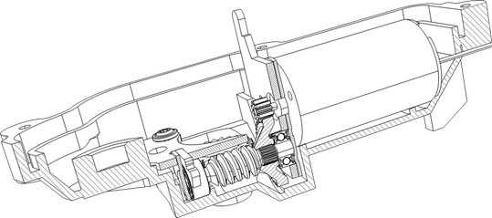

With Creo Illustrate, is it possible to export sections with hatched section faces as a vectorial PDF, including the hatching?
In other words, in the exported PDF all lines, including the hatching, should be vector lines, not bitmaps?

Hatching on section cuts is currently not possible in Creo Illustrate.
I would suggest voting on the idea below as we do consider the most popular ideas when considering future enhancements.
Creo Illustrate: Hatch lines on cutting planes - PTC Community

Thank you. Does this mean that this is currently only possible with Creo Parametric?
