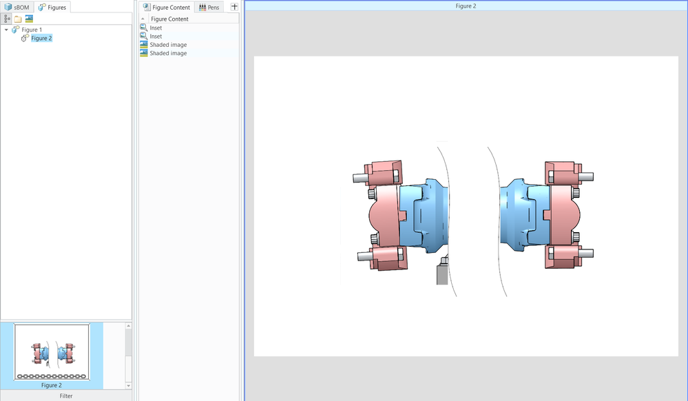

So there is a way to create a figure that is very close to what you are looking for using the insets and a 2D figure.
Here's the basic steps:
  1. Create a 3D figure showing the assembly in the correct orientation
  2. Add two insets that contain the details of each end of the assembly (See image 1 below)
  3. Turn off the borders for both insets
  4. Move the main view of the assembly outside the page (again see image 1)
  5. Now create a 2D figure from this 3D figure
  6. Hide the two inset views and select/delete the unwanted main view
  7. Unhide the insets and manually add the curved lines to indicate the truncated view (Image 2 shows a very rough example)

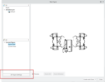

To include a shaded image you need to check the "Include shaded image" option in the 2D figure settings.
When creating the 2D figure select "2D Figure settings" option:

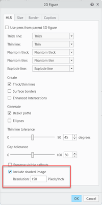

In the dialog check the "Include shaded image" option and set the required resolution:

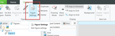

This can also be done for existing 2D figure via the "Figure Settings" button in the Figure ribbon:

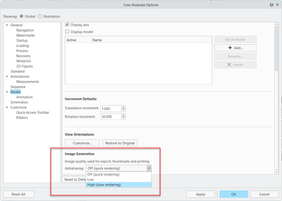

Might be worth checking your image quality setting found in Options>Global>Model, to be sure the output is of a good enough quality.
