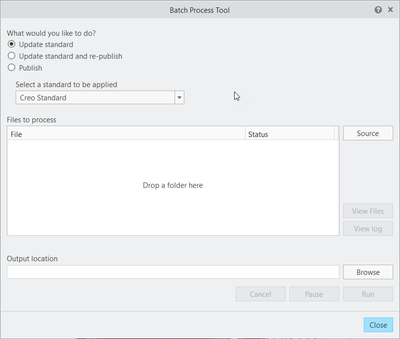

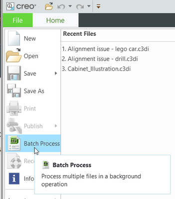

(currently using 9.0)    Hi Tom,  I'm trying to find the batch tool you spoke of.... where is it???       "In the upcoming 8.1 release you will be able to use a new batch tool to update the standards in multiple legacy files in one go."
Glen Whelden
Alert Innovation
Hi Glen,
The batch process tool can be found in the File menu (File>Batch Process).
Hope this helps.
