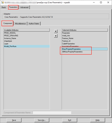

Hi Matteo:
you can export mass property parameters if you publish Creo View (PVZ) with Creo View Adapter or Save As PVZ with Creo Parametric.
You need to make sure you enable recipe option as displayed below, to convert Reported Mass properties & Alternate mass properties :

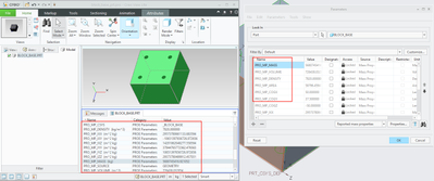

Once published you can see mass properties as below :
NOTE: Direct import of Creo Parametric files in Creo View wont convert any parameters.
