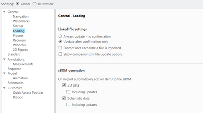

As long as you chose "Link" when you imported the source file the illustration will update when a newer version of the source file is found.
There are settings to let you control what happens when a source file is updated, they can be found in:
Options>Global>General>Loading
