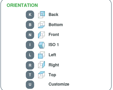

Thank you very much @agarland . I have more doubt. These standard orientations are actually not exactly the same when compared to the views as obtained from the drawings, as my team have used different planes . So for Example, I would define/customize a new view and type in the co-ordinates such that it becomes the exact front view when compared to the real physical part. Now for this new view, how can I add the new shortcuts such as K,B,N.  as shown in the image . I am unable to do this and this is mostly what I require. Thank you in advance. I have been searching this for a long time now.

Thank you very much for the reply and your efforts @agarland . So what I can do is that I will put in the correct co-ordinates to Top, Bottom, Front, etc so that instead of creating a new orientation, I will plug the values to these and use the shortcuts to view them quickly. Ok got it. Thanks a lot
